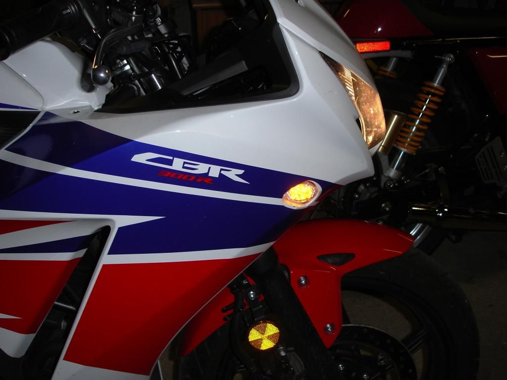

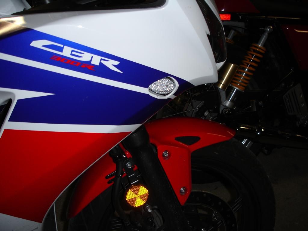

I bought these flush mount LED front turn signals and another set of resistors. I had to drill out some of the plastic signal mounting plate behind the fairing so the turn signals were centered. These signals are the smallest of this type I could find and they are still a tight squeeze.
Resistors are 3.29 free shipping on Ebay
2pcs Motorcycle Turn Signal Indicator LED Load Resistor Flash Blinker Fix Error | eBay
Turn signals are 8.35 free shipping on Ebay
Motorcycle Universal Flush Mount 15 LED Turn Signals Light Indicators Amber 12V | eBay
The LED signals work just like the stock signals with the resistors installed. They are on all the time and blink when you turn the switch on L or R.

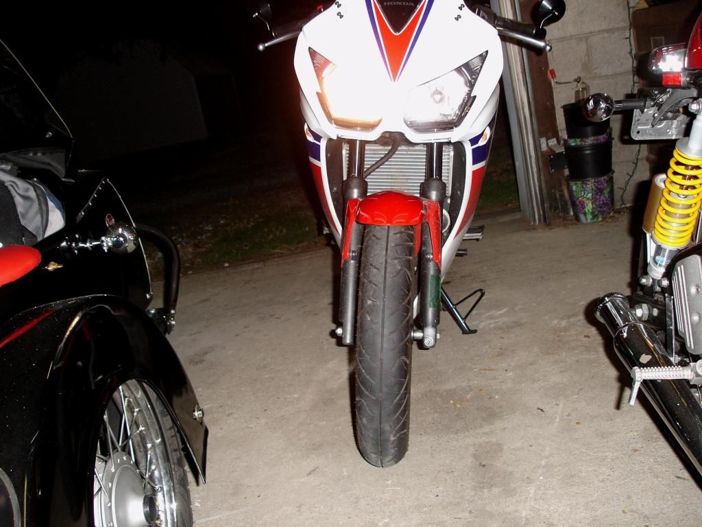

The signals are on but the headlight screws with the camera
I like these enough and I bought 2 other types that are similar but didn't fit because they were slightly too big. In any case I like them much better than stock but I am still open to either finding/fab something that looks more like if the factory decided to install flush mounts.

It looks like this would make it more difficult for someone in front of you to see your signaling? I'm assuming you do this just for styling, since this seems to greatly limit the amount of information you're passing forward.
Registered
Joined
166 Posts
Discussion Starter · #11 ·
I don't think there is a problem with the front signals being seen by traffic. Cars usually are to one side of the bike or the other but the flush mount signals can be seen from dead-on and way better than OE on the sides. The rear signals have more responsibility in my view than the front as far as safety goes. Except in the opposite case of when a turn signal is left on and the bike is going straight. Then the front signals become a safety factor
Registered
Joined
93 Posts
I kinda I see your point. I don't believe anyone to the direct left-right of you needs to see the turn signals. It would be more important to me (driving in my car) to look in the rear view mirror and see if you're signaling to turn/lane change before I begin my turn. My concern with this setup is it would be very difficult from the driver in front of you to see if your signaling. The stock reflector design is very good at focusing that light to the driver in front of you.
I'm a beginner and I use my turn signals very often. Motorcycle lighting requirements seem to be decades behind automotive lighting. If I removed the front bulbs on my car and just used my mirrors side markers it would be very difficult to communicate the same information to drivers in front of me.
I'm kinda a stickler for good lighting and making my intentions clear to other drivers though. :)
